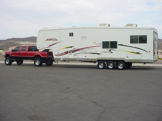

MAXDOUT Posted November 22, 2007 Share Posted November 22, 2007 (edited) My truck has 8" lift 37 inch tires, regeared to 488's and I pull a fifth wheel. Trailer axles are flipped, no big deal. If you think about it, flipping the axles only raises the trailer the amount of the axle tubes...3-4inch. Edited November 22, 2007 by maxdout Quote Link to comment Share on other sites More sharing options...

MAXDOUT Posted November 23, 2007 Share Posted November 23, 2007 (edited) Kitcat said: We looked at getting a 5th wheel with our Dodge 2500 with 6 inch lift and 37" tires. The dealership thought it was possible, but it was really close and made us nervous. We ended up with a bumper pull Raptor with 18 ft of cargo space. If your'e talking about the space between the bed of the truck and the 5th wheel, the hitch on 5th wheel is adjustable, along with the one in the bed. My buddy put bigger tires on his 5th wheel to help out. I guess its just a matter of opinion. If you look at my set-up I have plenty of clearance. Edited November 23, 2007 by maxdout Quote Link to comment Share on other sites More sharing options...
offroadracer Posted November 23, 2007 Share Posted November 23, 2007 maxdout said: If your'e talking about the space between the bed of the truck and the 5th wheel, the hitch on 5th wheel is adjustable, along with the one in the bed. My buddy put bigger tires on his 5th wheel to help out. I guess its just a matter of opinion. :jester: If you look at my set-up I have plenty of clearance. how does it tow ? does it make the trailer feel top-heavy? seems like it would up higher , more room for air to go under the trailer I was wondering,thinking of flipping mine Quote Link to comment Share on other sites More sharing options...
MAXDOUT Posted November 23, 2007 Share Posted November 23, 2007 Overall, it tows ok. I think the LIFTED TRUCK ON 37/38'S is the biggest part of it. Quote Link to comment Share on other sites More sharing options...

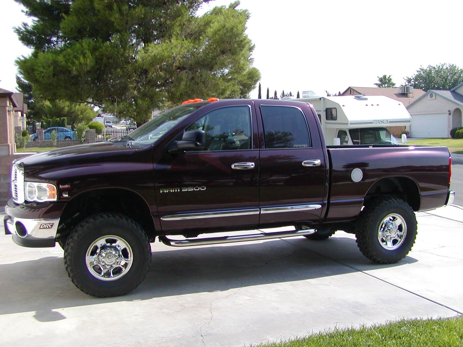

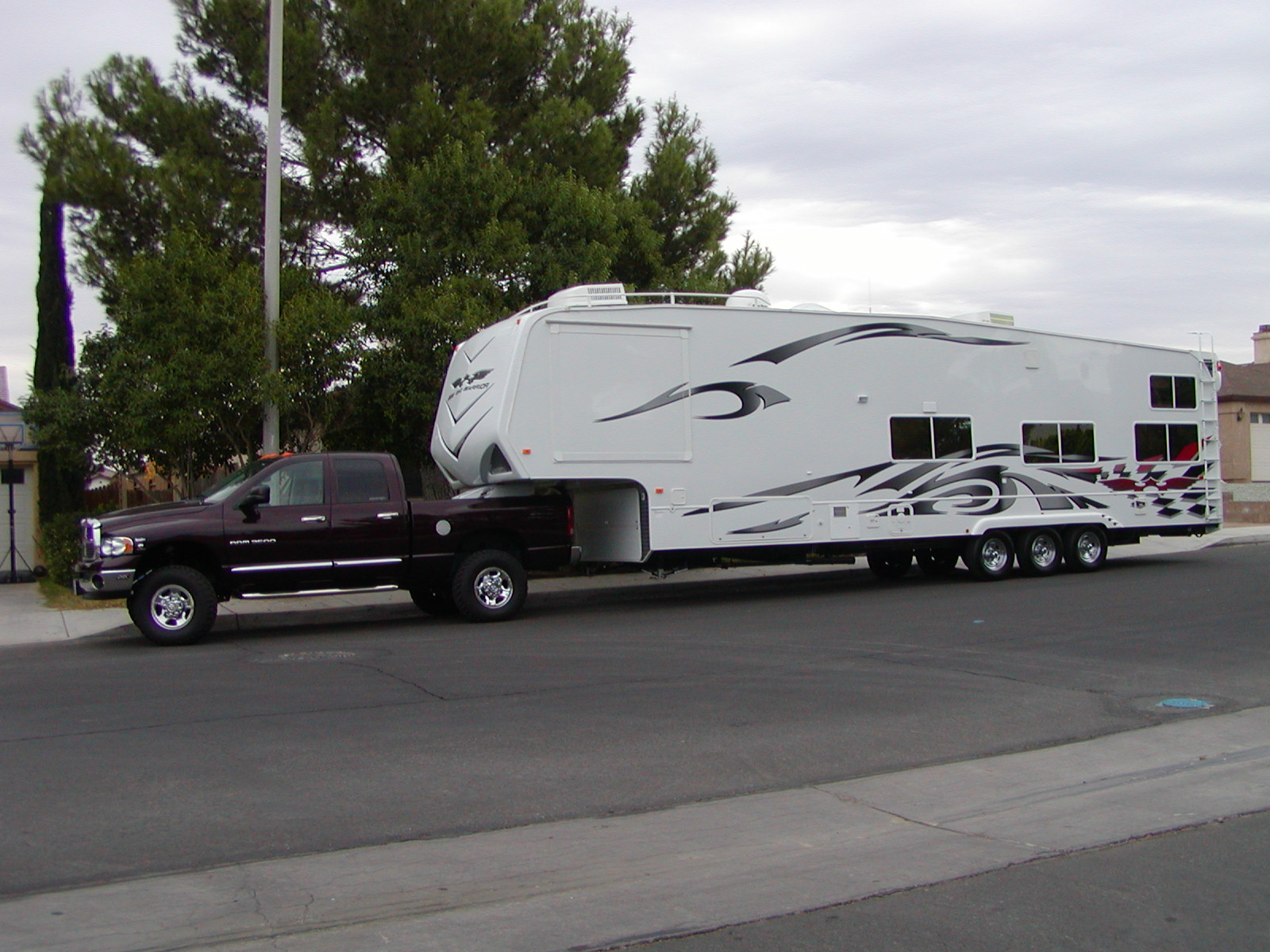

Jusdune Posted December 4, 2007 Share Posted December 4, 2007 I have a 3500 Ram with a 3in Kore lift on 35's, I pull a WW SLC3705 I did not want to flip the axles on my 5'er. I know alot of people flip the axels, but personally I dot not like it. The only thing I had to do was raise my hitch up one notch to make it higher, so when I slide it wouldn't hit the tailgate. With a lift that high you would need to flip the axels on the fithwheel. A good rule of thumb is to put fist on top of fist on your bed rail if it clears the fithwheel you should be alright. Good Luck! Quote Link to comment Share on other sites More sharing options...
