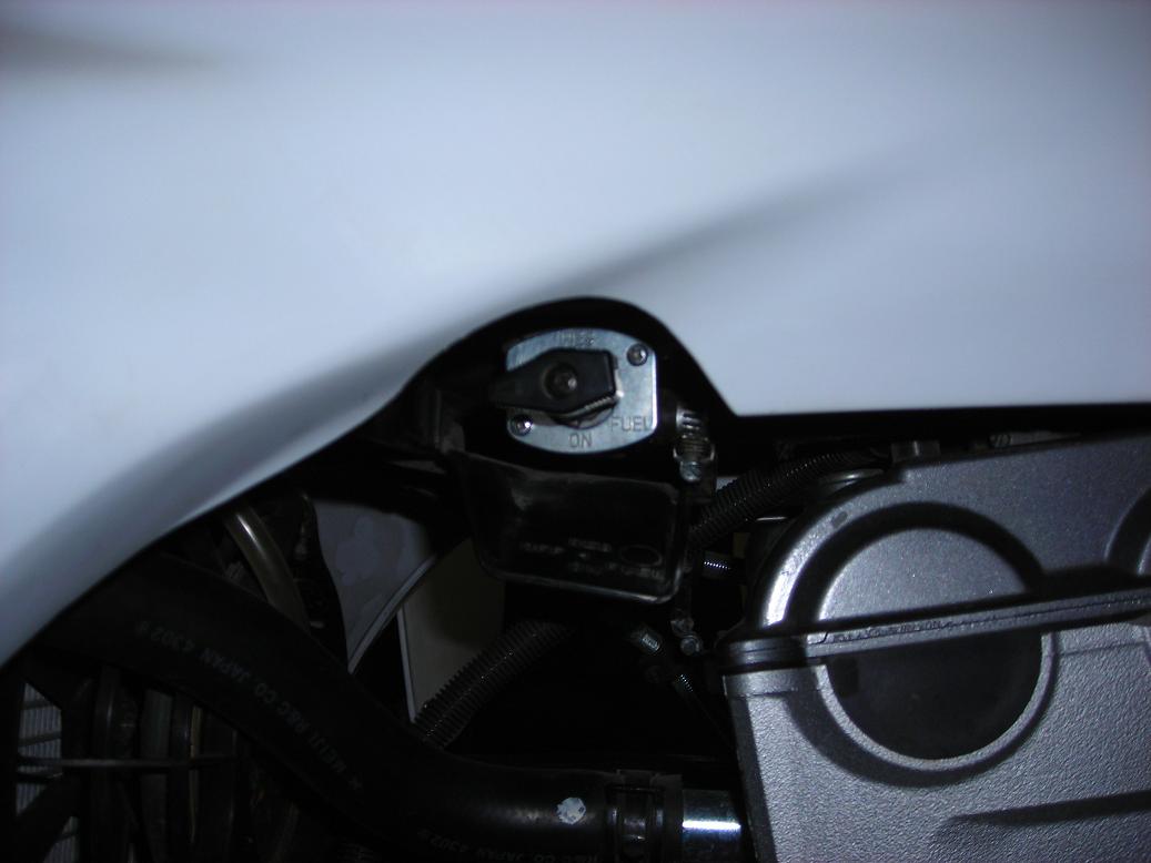

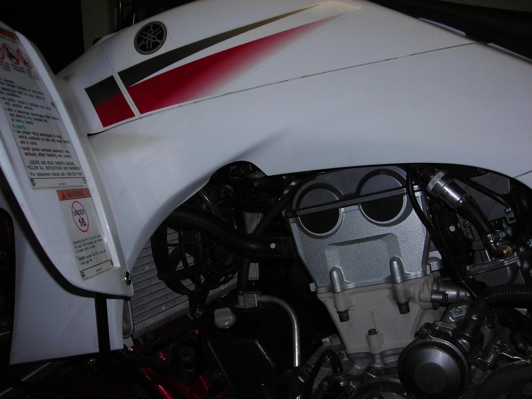

Randog Posted November 26, 2007 Share Posted November 26, 2007 Ever have a tough time turning your fuel on and off on your YFZ? I trimmed the plastic a bit to have better access to the valve. Worked Awesome. Yiah Yiah Check it... Quote Link to comment Share on other sites More sharing options...
offroadracer Posted November 26, 2007 Share Posted November 26, 2007 clean job randy.. Quote Link to comment Share on other sites More sharing options...
lvnalolife Posted November 26, 2007 Share Posted November 26, 2007 Looks good! Almost stock-looking. Quote Link to comment Share on other sites More sharing options...

indasand Posted November 26, 2007 Share Posted November 26, 2007 Good idea I think I'm a gonna copy that one..... Quote Link to comment Share on other sites More sharing options...

Randog Posted November 27, 2007 Author Share Posted November 27, 2007 ooow do mine next You got it Kayla. Just let me know when you go out again and I'll bring the tools. A sharpie, jig saw, and my dremmel with a sanding drum. It's a cool mod. Quote Link to comment Share on other sites More sharing options...

BLUE STEEL Posted November 29, 2007 Share Posted November 29, 2007 Nicely done. My turn now. Thanks for the tip. :eatdrink021: Quote Link to comment Share on other sites More sharing options...

sandshots Posted December 29, 2007 Share Posted December 29, 2007 the reason that knob is under the plastics is so your leg wont rub it and accidently shut it off. kinda useless though, i would of cut it too. Quote Link to comment Share on other sites More sharing options...
