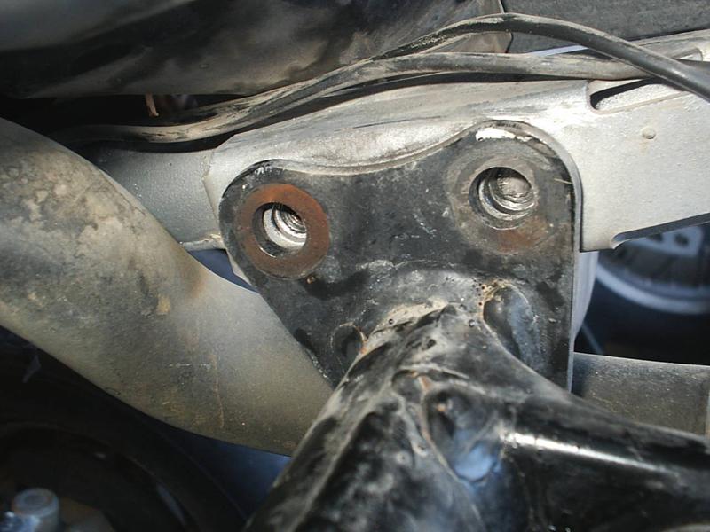

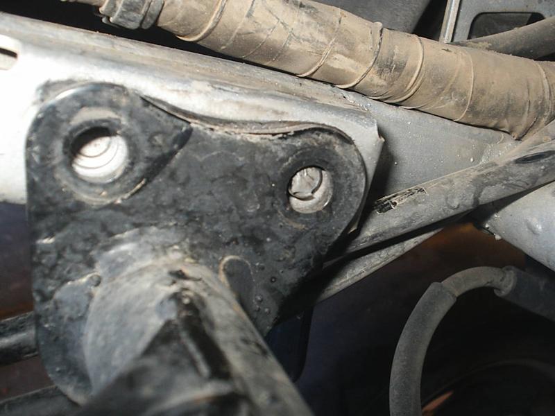

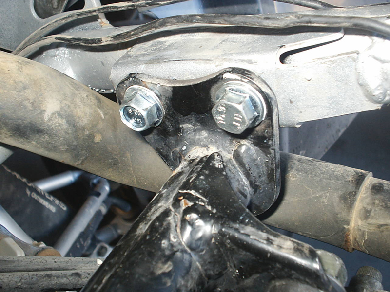

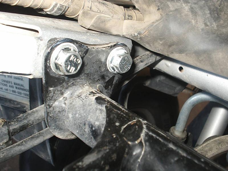

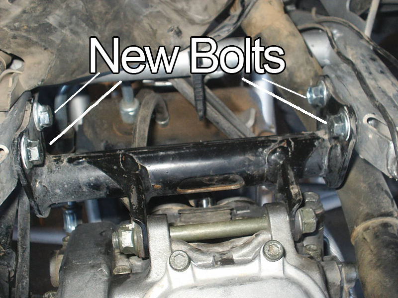

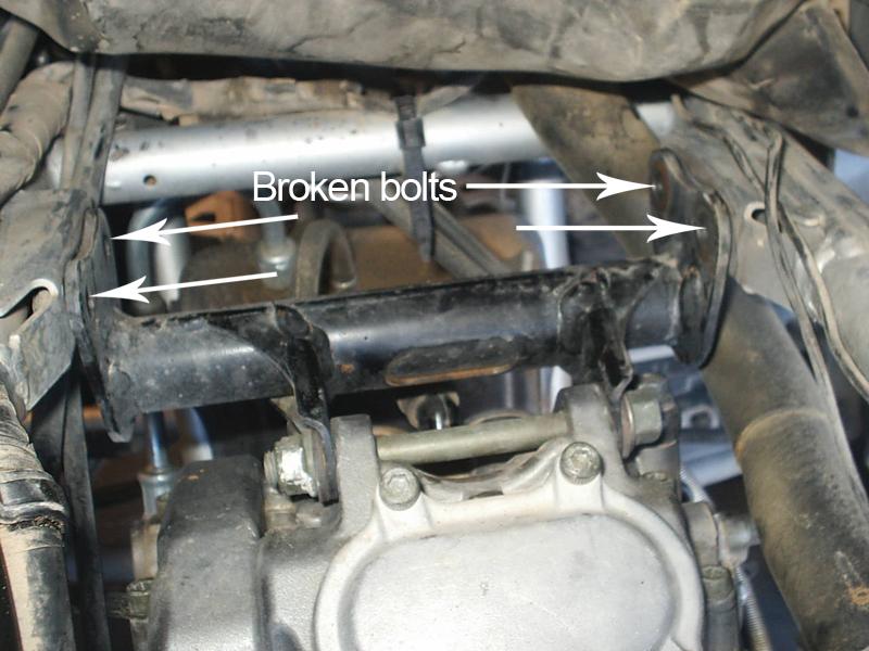

The other day when I went to go adjust my valves I noticed all 4 bolts were broken on the upper motor mount bracket to the frame. It might be a good idea to check yours before they break or, even worse, crack your frame from the extra vibration and movement when they come loose.
If they are broke, it's not that hard of a task to extract them. They come out rather easy since only the heads of the bolts break off and the threads aren't tight.
Tools needed to removed the broken bolts
center punch
90 degree angle drill
easy-out tool
Here is what mine looked like.
