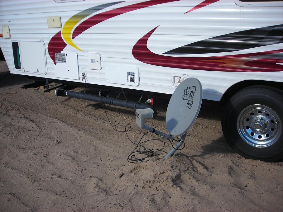

I found out I can find satelite signal by simply looking up at the sky! :MBdance: I just plopped the dish down and we turned it on and it worked! :D Ted simply called in the fight before we set it up and all we had to do was select the fight w/ the remote.

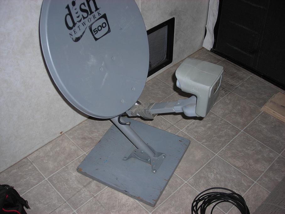

This may help, So check it:
Tri-pod, Schmi-pod. :freakin_nuts:
I just mounted a piece of 3/4 ply to the mount bracket.
:flipoff: Bring out a bucket of sand from home and pour it on the base. :flipoff:
It won't move even in big winds.

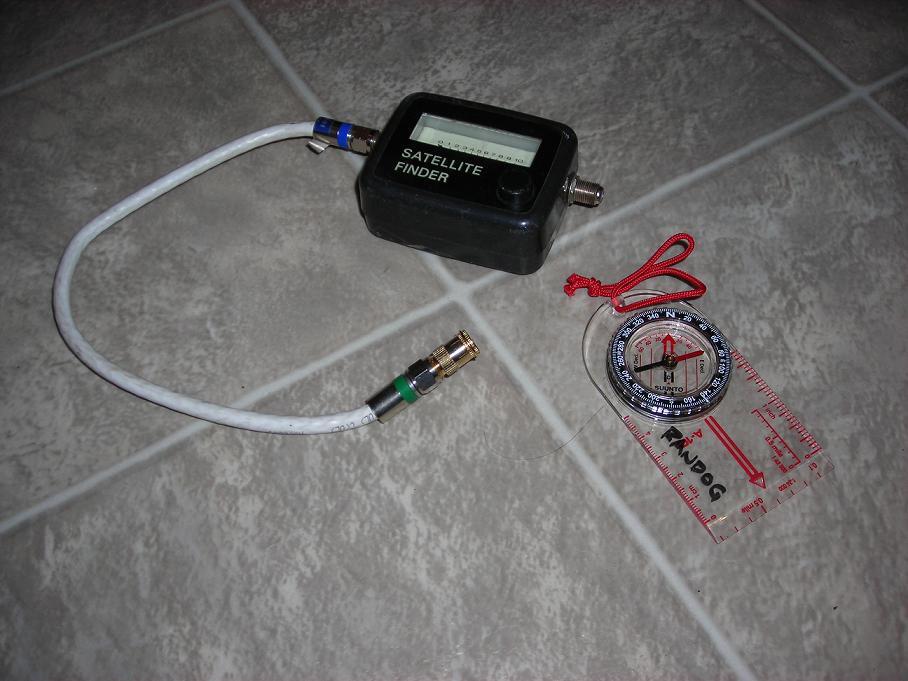

you may want to buy these:
The little compass works great to get the dish in the general area.
Dish Network is at about 160 degrees. Direct is about 145 degrees.
The satellite finder with a slide connector. I use those connectors in the desert.
That looks like a simple set up Randy, Thanks. If I can't get Dishfreak to set it up anymore, I'll invest in the tools. :headbang1:
