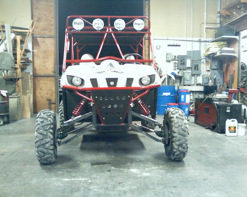

beau Posted January 4, 2008 Share Posted January 4, 2008 I love my long travel! 10 times more stable. I've had a few instances since I have installed it that I knew that if I didn't have it the chances of rolling were almost 100%. The only problem I have with it is now that I don't have to lift through the big stuff there isn't enough power. So I have recently spent quite a bit more money than I had originally planned on. Quote Link to comment Share on other sites More sharing options...

90+ PLUS Posted January 6, 2008 Share Posted January 6, 2008 True, but it's bad farm equipment! yep. does your rhino sit really high or does the pic make it look higher Quote Link to comment Share on other sites More sharing options...

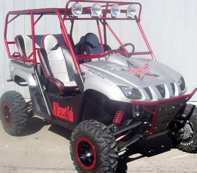

beau Posted January 6, 2008 Share Posted January 6, 2008 yep. does your rhino sit really high or does the pic make it look higher Well, the pic makes it look a bit higher because of the lower angle but when people are in it it squats a little more. This pic is a better look at how it sits. The kit on this one is the HCR +6 kit with Fox remote reservoirs. Clicky If you do the LT thing make sure you get the frame supports to prevent ripping the a-arm bolts through the frame cause if you hit a big rock at speed or land funny off a jump they will rip out. I know I don't have them in the pic but they are on now. Quote Link to comment Share on other sites More sharing options...
90+ PLUS Posted January 6, 2008 Share Posted January 6, 2008 (edited) wow those look strong. what ever you do dont get SoCal Fab Edited January 6, 2008 by 90+ PLUS Quote Link to comment Share on other sites More sharing options...

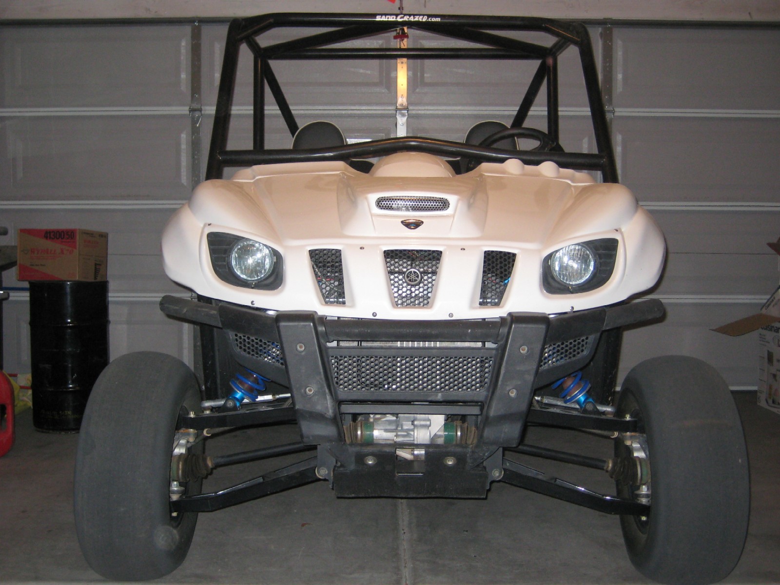

SDShop Posted January 8, 2008 Share Posted January 8, 2008 Long Travel :beer_bang: Quote Link to comment Share on other sites More sharing options...

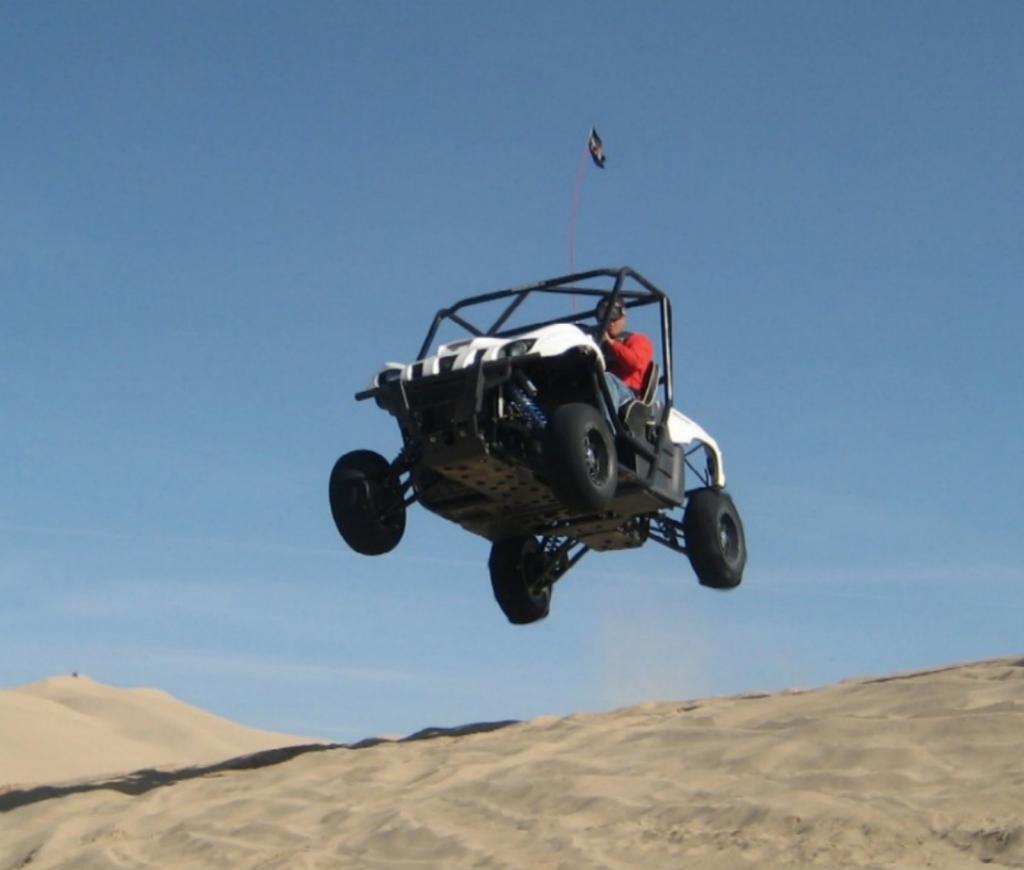

geeza76 Posted February 8, 2008 Share Posted February 8, 2008 Madd air pic by Darry at Sand Crazed. Check his shop out located on Decatur, he'll set you up with a long travel and not sell you crap you don't need. Quote Link to comment Share on other sites More sharing options...
