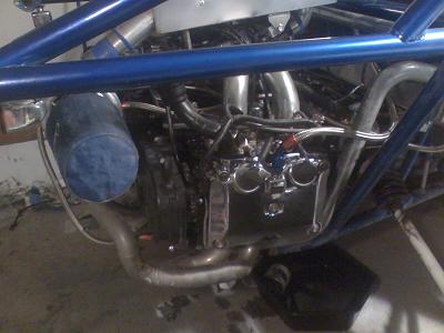

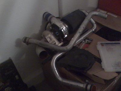

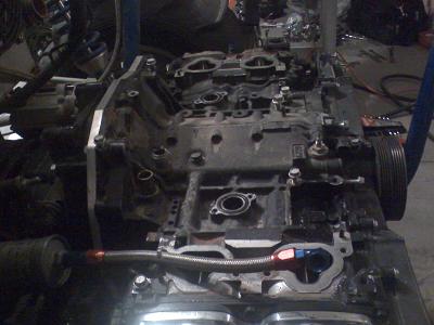

lvnalolife Posted February 5, 2008 Share Posted February 5, 2008 Started the tear down last night to fix the buggy. Got this far in about 3.5-4 hours. I will be pulling the motor tonight and possibly split the case to see how bad the rod bearing damage is. Hopefully it is not too bad. Started out like this... So far it looks like this after last night... I had purchased a replacement DOHC motor from a friend but after doing a lot of research it will take a lot more than I expected to swap from my SOHC motor to the DOHC. So if anyone wants a DOHC EJ25 2.5L Subaru motor let me know. Quote Link to comment Share on other sites More sharing options...

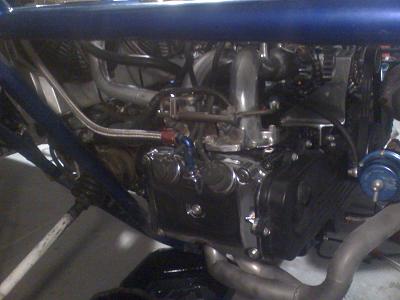

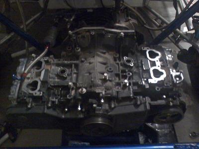

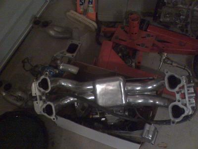

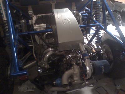

lvnalolife Posted February 12, 2008 Author Share Posted February 12, 2008 Well, I ended up taking the heads off of both motors on Sat to see if the pistons were different like someone had thought. The difference was so minor I decided to go ahead with the swap by putting my SOHC heads on the replacement block. Also saw what went out on my motor. The number 3 conecting rod bearing went out. the rod has signifigant play. I worked on it Sun and for a while last night (about 6 hours) here is how it sits as of last night. I would have fired it up but got the wrong oil filter while I was at the parts store. Woo hoo, should have it for this weekend as long as my shade tree mechanic skills are ok! Some pics... Quote Link to comment Share on other sites More sharing options...
lvnalolife Posted February 12, 2008 Author Share Posted February 12, 2008 UPDATE! I got a wild hair up my a$$ and when to the parts store at lunch and got the correct oil filter. Then ran by my house put it on, topped off the coolant and put the oil in. Drum roll please...... It fired right up! I did find one leak where I forgot to tighten the coolant return line on my turbo. Oops, but it is running and idling perfect. I guess my shade tree mechanical skills paid off. That and I had a service manual to help me re-build everything for the swap. :freakin_nuts: Quote Link to comment Share on other sites More sharing options...
