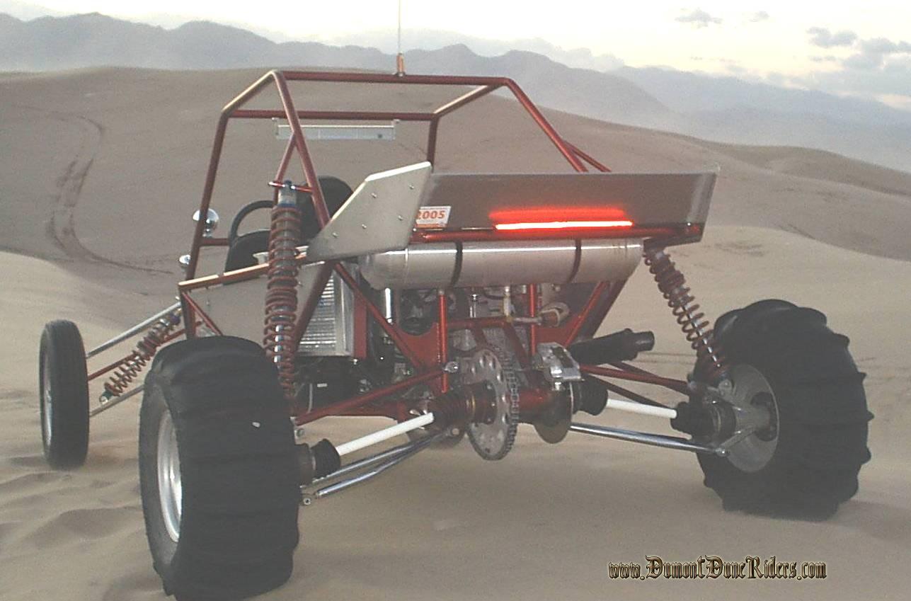

1320 Posted March 29, 2006 Share Posted March 29, 2006 Discuss: long travel suspension. 1.shock/ spring 2. shock/spring, shock res 3. air shocks, I don t know much about these, limitations? 4. air ride 5. air ride, shock res Quote Link to comment Share on other sites More sharing options...

EY3BA11 Posted March 29, 2006 Share Posted March 29, 2006 what about airbags... Funco's seem to dune rather well using airbags.. Personally... 5 Link w/ coil carriers, and bypass's on each corner... 5 link allows for a lil more travel and less CV plunge so they last longer.. just my 2 cents... Quote Link to comment Share on other sites More sharing options...

raspadoo Posted March 30, 2006 Share Posted March 30, 2006 Bypass' are the way to go! just changed out my rear kings on my Gen 3 Funco. Switched to triple bypass, used them at Dumont last weekend What a difference!! Quote Link to comment Share on other sites More sharing options...
sandbar51 Posted March 30, 2006 Share Posted March 30, 2006 Bypass' are the way to go! just changed out my rear kings on my Gen 3 Funco. Switched to triple bypass, used them at Dumont last weekend What a difference!! not enough diffrence to hold my trans together. Does anyone else think airbags would be a good option for my mid travel Chenowth?Only for the rear I need to hold up an acura V6 and the torsion bars are not doing it.......low rider Quote Link to comment Share on other sites More sharing options...
1320 Posted March 30, 2006 Author Share Posted March 30, 2006 I talked with air ride tech at the sema show, and they said it was their stuff on some funco cars. He also explained to me how to do it. My question is, the cost seems to be about the same as a spring shock and res, but will air ride perform. I m looking for a nice ride. I think that with alittle programming, that hieght sensors and speed input could help control the ride. Ie speed goes up, the car lowers itself. If the wheel extends, it knows that it need more air to land, if the front end is raised like climbing a hill, the car lowers itself. The car leans left, it preloads the right side alittle more. I just want a nice soft ride.....really. Quote Link to comment Share on other sites More sharing options...
Don29palms Posted March 30, 2006 Share Posted March 30, 2006 The rear air bags on a Funco are not special but the front King shock/airbag combo are proprietary parts built for Funco. Quote Link to comment Share on other sites More sharing options...
