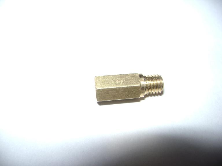

dumontdude10 Posted March 4, 2008 Author Share Posted March 4, 2008 (edited) I bought this jet for it a 148 Edited March 4, 2008 by dumontdude10 Quote Link to comment Share on other sites More sharing options...
EY3BA11 Posted March 4, 2008 Share Posted March 4, 2008 Is there a star stamped on it.. If there isnt then its not a true Kehin jet.. I would only use true Kehin jets as other manufacturers only get CLOSE and not exact.. Quote Link to comment Share on other sites More sharing options...
EY3BA11 Posted March 4, 2008 Share Posted March 4, 2008 Also if all you are doing is replacing the main.. take a 17mm wrench get it in there.. pop the float bowl plug out.. then grab a 6mm socket and ratchet and take the old jet out.. and put the new one in.. Remember these are brass and dont require a lot of force before they break Quote Link to comment Share on other sites More sharing options...
Warrior07 Posted March 4, 2008 Share Posted March 4, 2008 just make sure you give it a little smidge of a tightening cause if you don't and that ma fackacckaass comes loose watch out Quote Link to comment Share on other sites More sharing options...
dumontdude10 Posted March 4, 2008 Author Share Posted March 4, 2008 were would the star be??? Quote Link to comment Share on other sites More sharing options...
britincali Posted March 4, 2008 Share Posted March 4, 2008 were would the star be??? On the side right before the jet size number ONLY USE GENUINE KEIHIN JETS you wouldnt believe how many headscratchers Ive had from crap non OEM jets, they are all over the place size wise.... Heres a pic of the lazy star (showing its a genuine) Quote Link to comment Share on other sites More sharing options...
britincali Posted March 4, 2008 Share Posted March 4, 2008 Fron the look of your pic yours aint a gen jet, if stamped 148 it could be as small as a 140 or as big as a 160 Go back to the shop and ask for the real thing Quote Link to comment Share on other sites More sharing options...
dumontdude10 Posted March 4, 2008 Author Share Posted March 4, 2008 i bought it at mountian motorsports in ontario Quote Link to comment Share on other sites More sharing options...
dumontdude10 Posted March 4, 2008 Author Share Posted March 4, 2008 what would go wrong if i put it in with out it being a star Quote Link to comment Share on other sites More sharing options...
britincali Posted March 4, 2008 Share Posted March 4, 2008 what would go wrong if i put it in with out it being a star You could be lean you could be rich you could be fine, like I said its a crap shoot with non OEM jets. What size is stamped on them in not neccesarly the size. Say your running a 145 and are lean, you got the 148 to make it richer rite? Well with this jet it could go even leaner on you..... Quote Link to comment Share on other sites More sharing options...
britincali Posted March 4, 2008 Share Posted March 4, 2008 Ok I think if figure a way of making this simple... You know when you have a cheapo set of tools all the sockets are a little loose and the wrenches round stuff off? Well if you go get a decent set of tools everything fits better and you round off less bolts, the sockets are stamped the same size but in reality they aint the same Quote Link to comment Share on other sites More sharing options...
