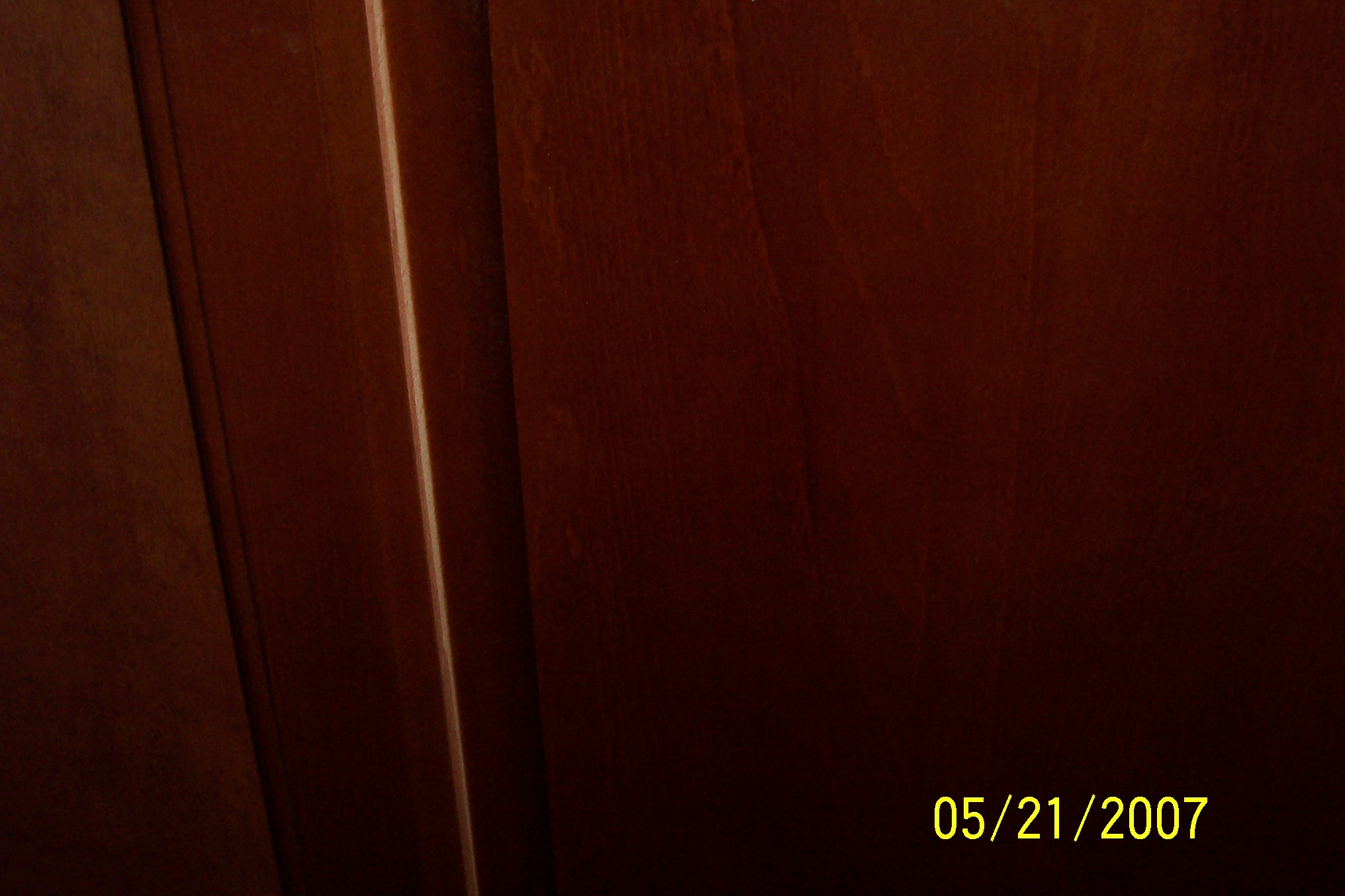

Danielle Posted March 27, 2008 Share Posted March 27, 2008 Right on...I love it! Yep, got the cherry/tan interior. Mine takes alittle bit to ignite when the tanks arent full but other then, nothing yet....it will be its second time out in 2 weeks so we'll see. Im worried about the pop out. Why? As for the cabnets,I didn't pay attention but if you are from vegas watch out they swell in the heat on the doors and then the stain seperates.Here is a pic of mine and you can see what I am talking about. Quote Link to comment Share on other sites More sharing options...

SandBox_Kid Posted March 27, 2008 Share Posted March 27, 2008 Why? As for the cabnets,I didn't pay attention but if you are from vegas watch out they swell in the heat on the doors and then the stain seperates.Here is a pic of mine and you can see what I am talking about. Stain doesn't seperate from the wood. If it was stained the stain actually soaks into the wood. Chances are it has a faux finish like a laminate that is lifting and needs to be re-glued before it gets worse. It's a little hard to tell by the picture though. Nice hauler! :boyyy: Quote Link to comment Share on other sites More sharing options...

Danielle Posted March 28, 2008 Share Posted March 28, 2008 Stain doesn't seperate from the wood. If it was stained the stain actually soaks into the wood. Chances are it has a faux finish like a laminate that is lifting and needs to be re-glued before it gets worse. It's a little hard to tell by the picture though. Nice hauler! No it is solid wood,These trailers are made in Cali where there is cooler temps and humidty,so during the summer when it got really hot and the trailer was in this climate for the first time the doors of the cabnets swelled and there for seperated from the edge and that is what we were left with.So warrior is trying to figure out what to do about it as my trailer is not the only one. We had probs with grey water draining from shower. Heard other complaints of this also. I think some of the fittings weren't tightened or cross threaded. Our amp blew, had a razorblade slice in carpet of master suite. The sink covers are known to warp, and I think that the hot water problem can be fixed by taking out an inline fuse thingy in the hot water compartment. You can call WW to confirm the h-water thing. As long as you don't have to deal with Wheeler in Vegas you should be good. You are exactly right we had to do that and now it works great.It only took 3 trips with cold showers and no hot water to finally get it figured out. Quote Link to comment Share on other sites More sharing options...

SandBox_Kid Posted April 9, 2008 Share Posted April 9, 2008 No it is solid wood,These trailers are made in Cali where there is cooler temps and humidty,so during the summer when it got really hot and the trailer was in this climate for the first time the doors of the cabnets swelled and there for seperated from the edge and that is what we were left with.So warrior is trying to figure out what to do about it as my trailer is not the only one. You are exactly right we had to do that and now it works great.It only took 3 trips with cold showers and no hot water to finally get it figured out. Sorry, but in the 15 years I've dealt with cabinet making and installing I have never seen solid wood seperate. I have only seen laminates (wood, paper or plastic) separate or pull off. If you look at the picture here close enough you can clearly see what looks like a wood laminate, laminated to a substrate (usually mdf or particle board). Hardly anything is built from solid wood anymore...just parts of it. No one wants to pay for it. Trust me. If you could provide a better picture I am offering to provide a possible solution. I just need to see more to understand where it is separating. Quote Link to comment Share on other sites More sharing options...
