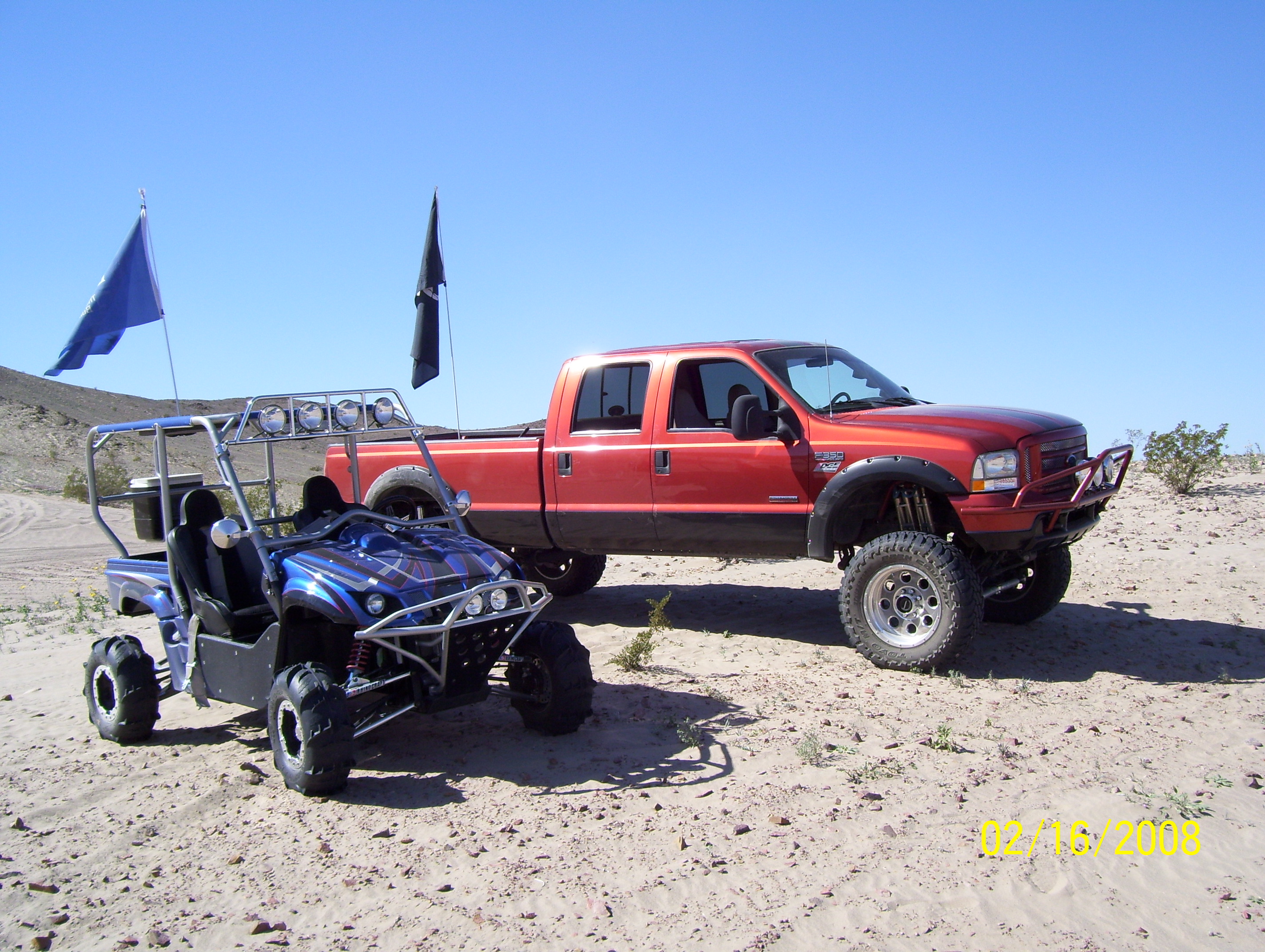

MAXDOUT Posted March 30, 2008 Share Posted March 30, 2008 Check out the ones Im running on my Rhino. They work great. Quote Link to comment Share on other sites More sharing options...
Free Agent Posted March 30, 2008 Author Share Posted March 30, 2008 Check out the ones Im running on my Rhino. They work great. Can ya climb with them? What kind are they? Quote Link to comment Share on other sites More sharing options...
MAXDOUT Posted March 30, 2008 Share Posted March 30, 2008 ITP Sand Stars size 26x10x12 on real beadlock rims. And yea it climbs pretty good, for a Rhino. Quote Link to comment Share on other sites More sharing options...
