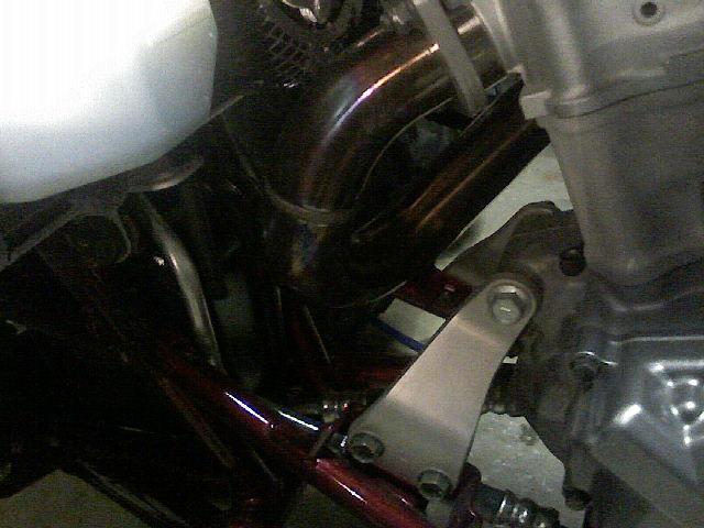

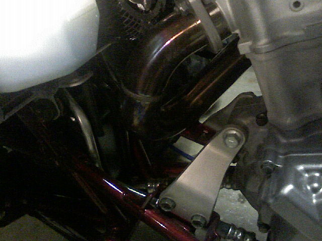

CTD Power Posted March 31, 2008 Author Share Posted March 31, 2008 (edited) Well i have had this pipe for two years and it looks new still but on my other 400 (the one im talking about) i took it out one weekend and it looks really dark,brown,dark blue, almost black looking. Its 3 1/2 turns now. Do i need to change the main jet to richen it or just turn that screw out where i drilled the brass thingy out off? thanks Edited March 31, 2008 by CTD Power Quote Link to comment Share on other sites More sharing options...

CTD Power Posted March 31, 2008 Author Share Posted March 31, 2008 What do i do to get it to run richer? The reason why i worry is b/c my 05 400 has the same exact set up and the yoshi has been on for years and it has hardly any color to it at all,it looks new still,now on my 07 its been on for 2-3 days and looks very bad. Quote Link to comment Share on other sites More sharing options...

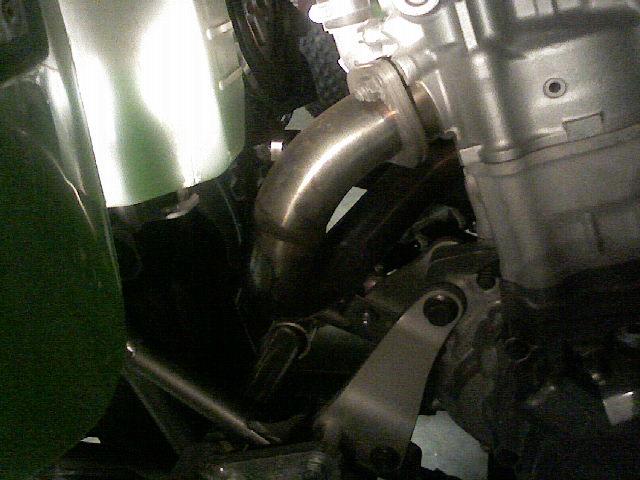

CTD Power Posted March 31, 2008 Author Share Posted March 31, 2008 3 years old 2 days old Quote Link to comment Share on other sites More sharing options...

powerhouse Posted April 1, 2008 Share Posted April 1, 2008 What do i do to get it to run richer? The reason why i worry is b/c my 05 400 has the same exact set up and the yoshi has been on for years and it has hardly any color to it at all,it looks new still,now on my 07 its been on for 2-3 days and looks very bad. the 05 and the 07 are different size carburetors , and camshafts so , the tune is going to be different ! Quote Link to comment Share on other sites More sharing options...
CTD Power Posted April 1, 2008 Author Share Posted April 1, 2008 Well just to be safe i put in a 165dj and took out my 160dj and in my older 400 i put in a 170 and so far everything is working perfect, a 160 in this one was running like crap. My new one ran pretty good with a 160 but i thought i would be safeer putting in the 165. Man what a mess all this stuff is,now i can change jets without unhooking anything and in 5 mins lol Quote Link to comment Share on other sites More sharing options...
