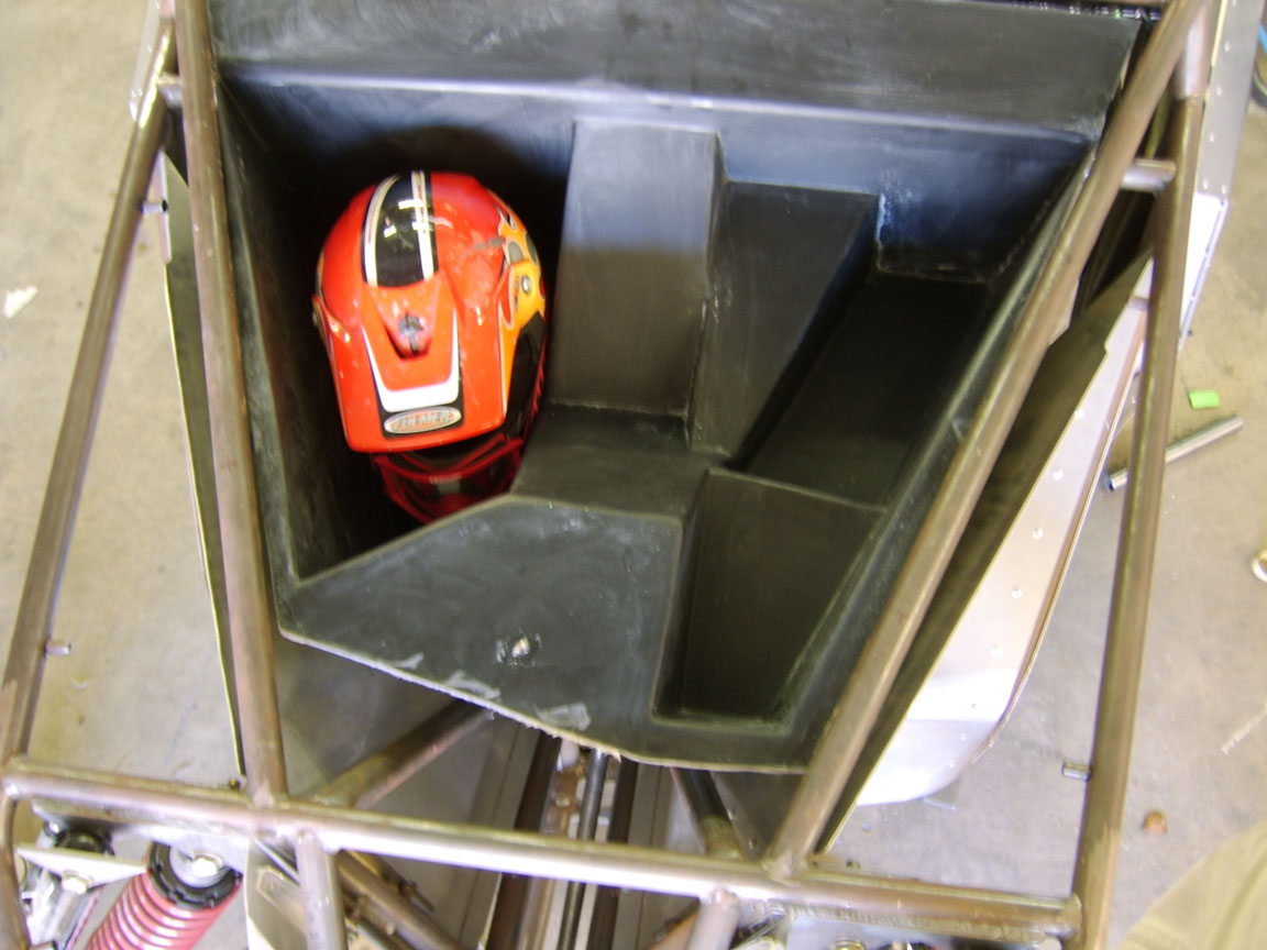

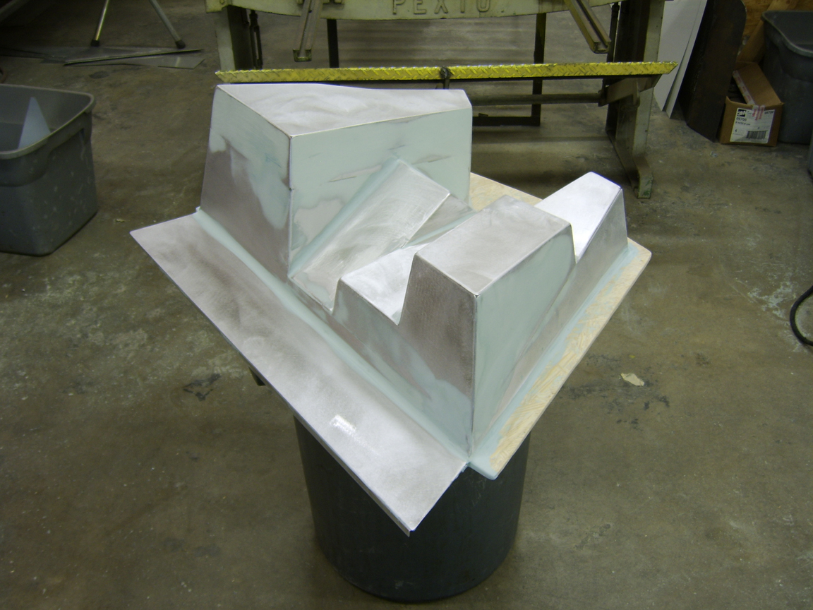

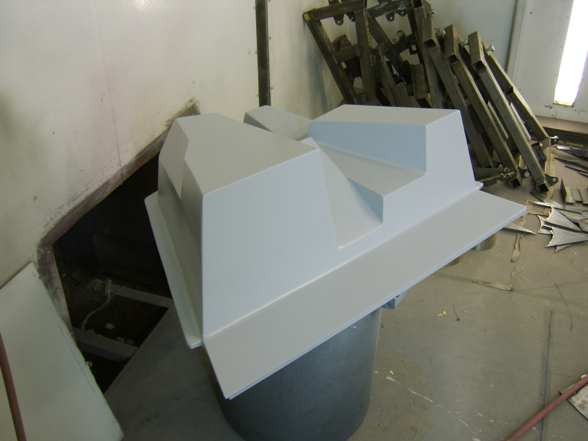

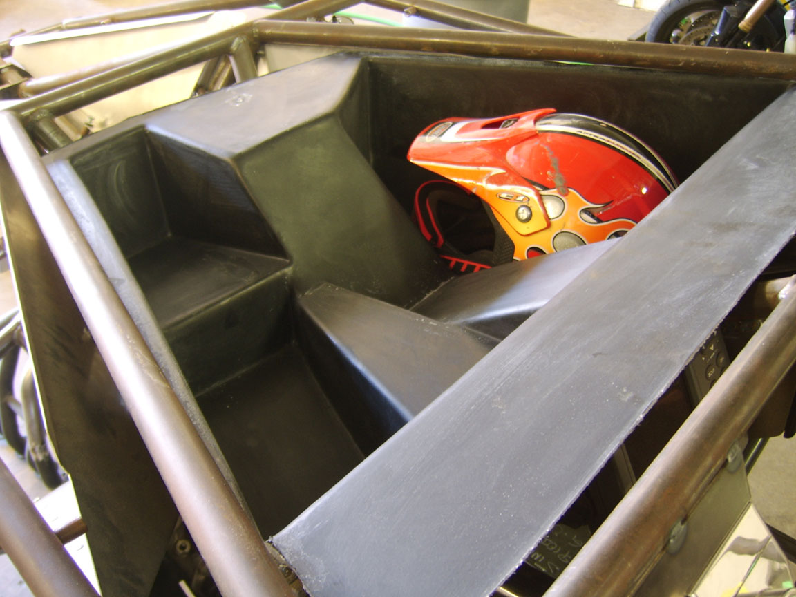

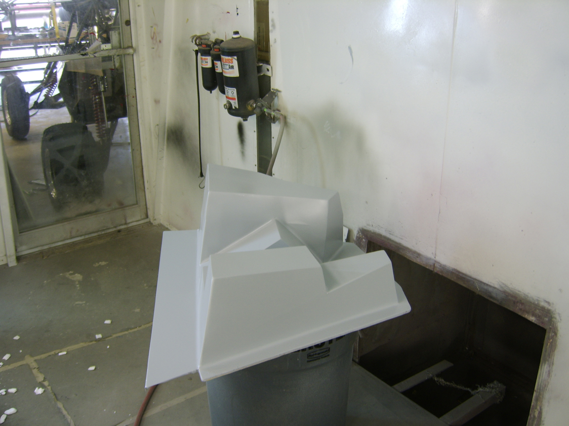

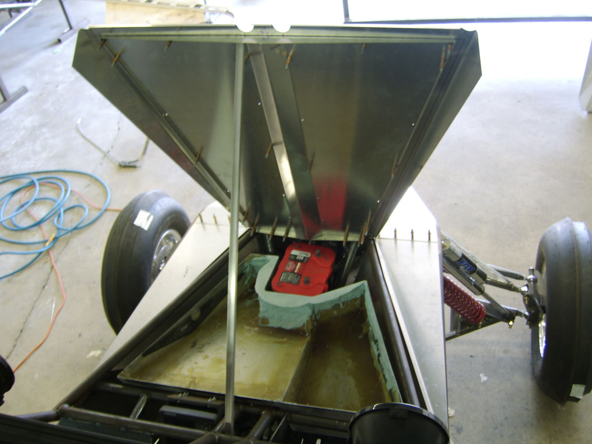

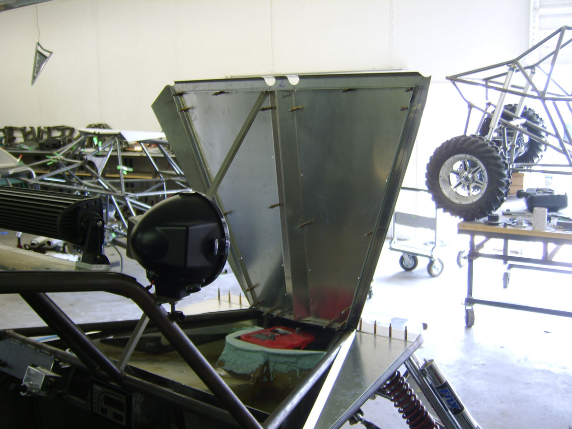

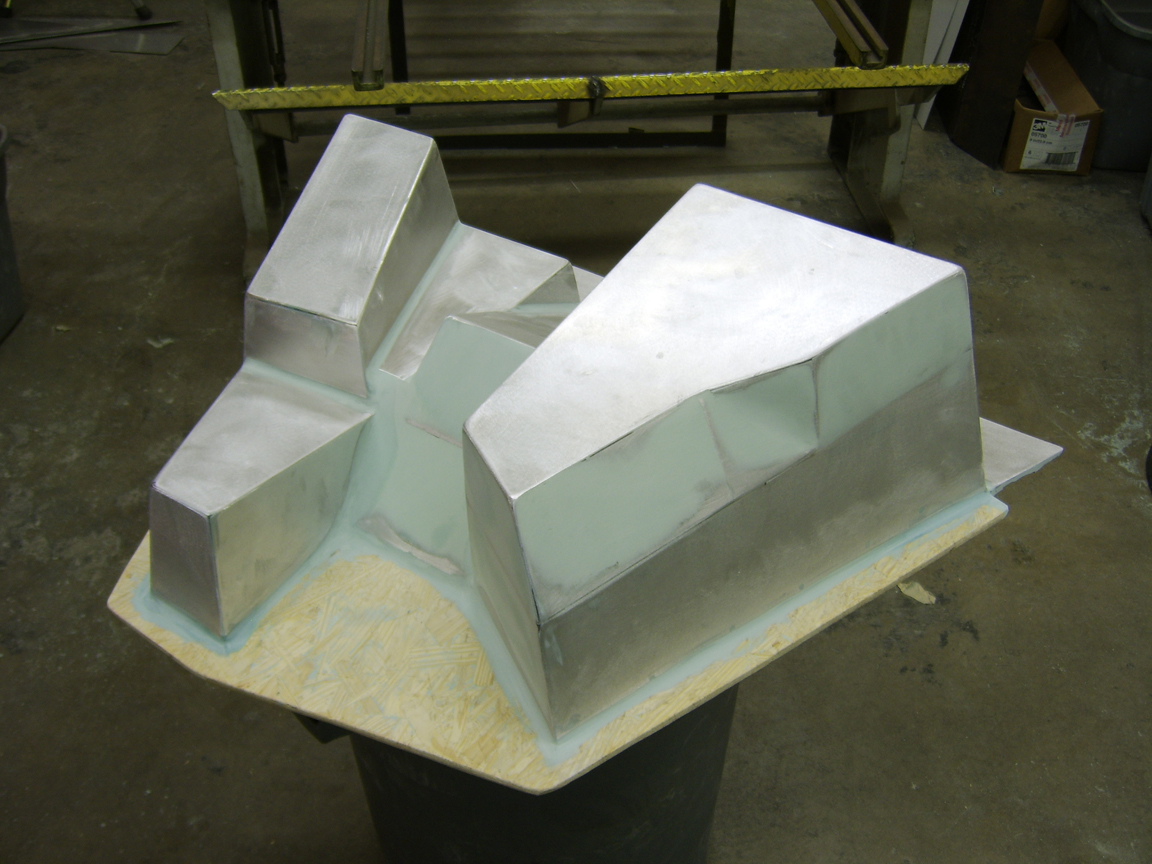

Yoshi Posted May 17, 2008 Author Share Posted May 17, 2008 (edited) I built a storage compartment for the nose, and set the hood up to hinge forward to give a lot of access space. The black part is the first piece off the mold I built, I will modify it, then build a new mold to reproduce the final parts that will then be shot with bed sprayliner.. Edited May 17, 2008 by Yoshi Quote Link to comment Share on other sites More sharing options...

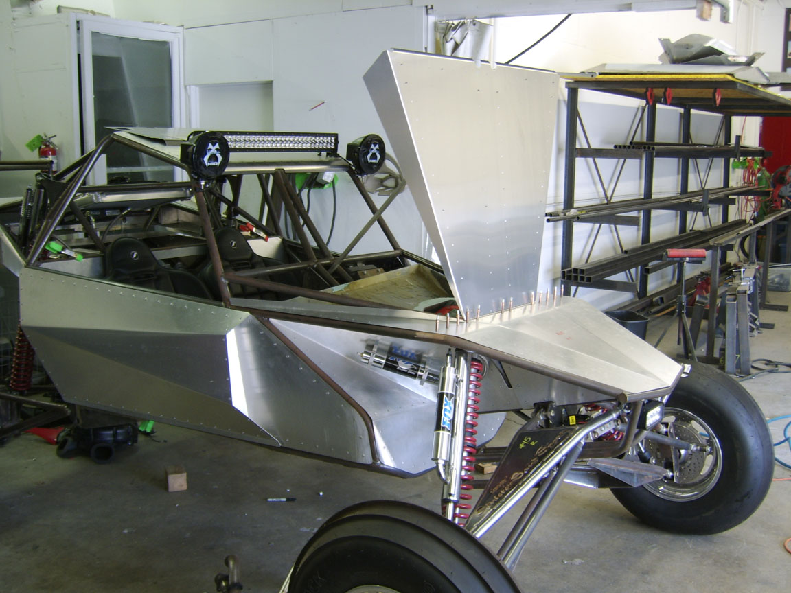

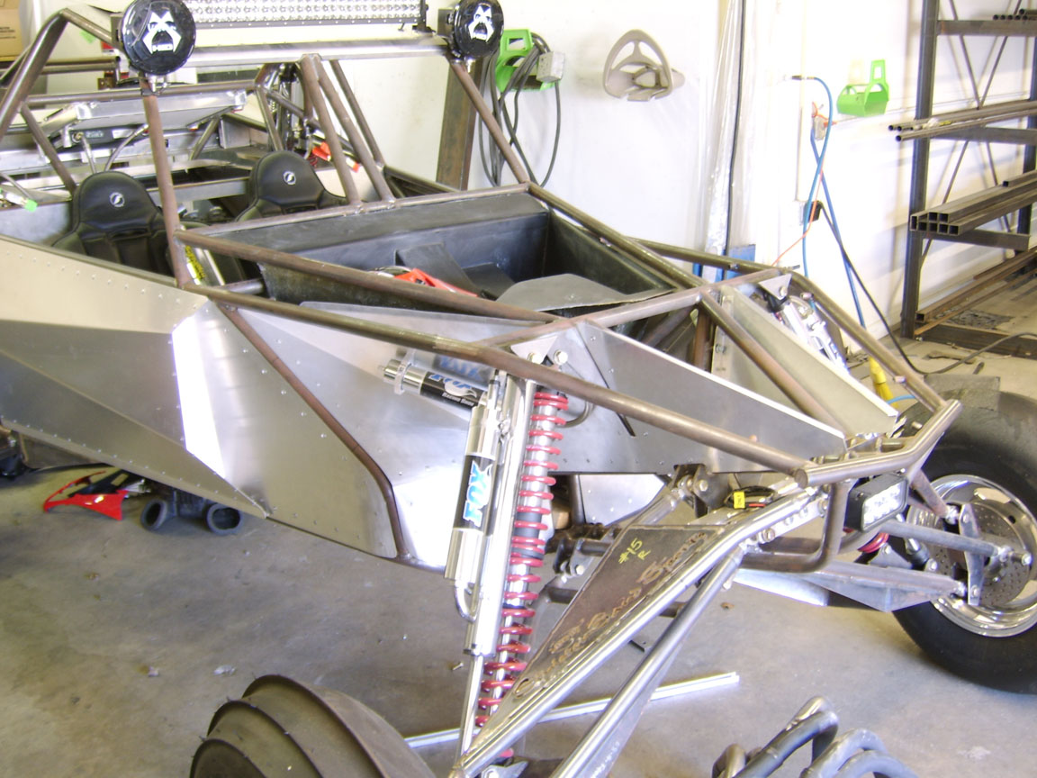

Yoshi Posted May 18, 2008 Author Share Posted May 18, 2008 (edited) Very clever! :dance: But is that thing ever gonna see any sand? Let's see some action pics! :stir: Getting close. The new aluminum airbox should be in Tues. or Wed. Also waiting on the new brakelines to show up. Then I gotta plug up the harness, run the power steering lines, fuel lines and radiator lines and she'll be ready. This rail has gone from design stage, to where it sits now, including building fixtures to reproduce the frames, suspension, and all the aluminum work, as well as building 5 other chassis off the jigs and a few full sets of panels in about 7 months, which I think is pretty good considering the amount of prototype work involved, and that it has actually been as complete as it is now for almost 2 months, waiting on things like the motor, airbox, and other odds and ends. Build time will be a lot quicker once I move into production, but prototypes are never fast, especially when your trying to build something so detailed...... There are a lot of people waiting to see this thing, and a lot of potential buyers lined up as well, so I am not gonna rush it . I wanna make sure it exceeds all the expectations people have, and I expect a huge response from the public when it debuts........... Edited May 18, 2008 by Yoshi Quote Link to comment Share on other sites More sharing options...
