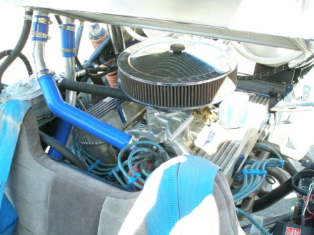

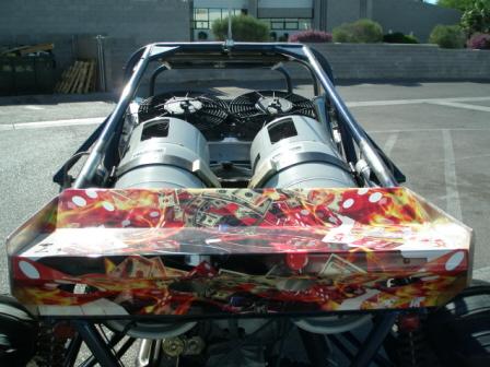

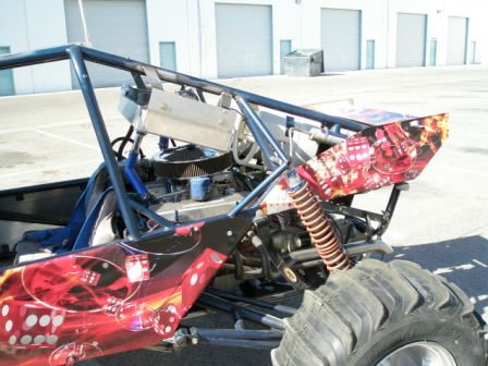

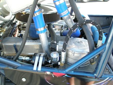

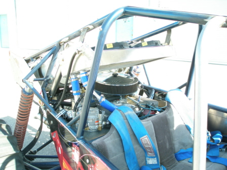

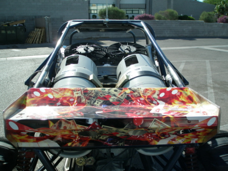

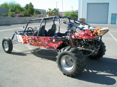

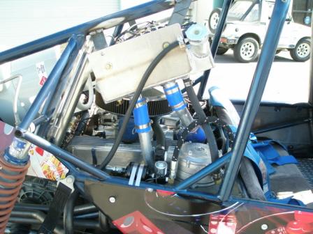

JD.... Posted June 25, 2008 Share Posted June 25, 2008 Hey people. I just did a propane conversion on an older play-tech sand car that a customer brought to our shop. I thought that I would share this with you as I believe it may help people with bad running carb setups and also eliminate some of the gas hazards. The system is real easy to install and makes real good power. I will have a video from the dunes real soon but you can hear it running in this little video that we shot. This system is mounted on a 215 Buick V8 making about 300 HP. Other than the mounting of the tanks, the kit can just bolt on. It will also run a turbo system with no problem. The octane level is about 115 and it allows you to advance your timing making good power with no detonation. One of the safety features is that it will not spill in a roll over and if you are in a steep climb it will not flood. It has a very low stall rate compared to gas and if you buy from a propane company such as pro flame it runs about $3.50 a gal. compared to the high cost of race gas. Here are some pics of the install and a short vid. Video Quote Link to comment Share on other sites More sharing options...
Randog Posted June 25, 2008 Share Posted June 25, 2008 Good job JD. Man, That sucker sounds RIPE! Not looking to convert, but how's the mileage in comparison to race gas? Thanks for sharing. :peek: R- Oh yeah, keep the flexible whip. just sayin' Quote Link to comment Share on other sites More sharing options...
britincali Posted June 25, 2008 Share Posted June 25, 2008 My dad has a GMC yucon converted to LPG, it runs bitchin and after 20+ k hes yet to have an issue. On another note I would NOT wanna be in that back seat if that coolant hose ever blows........ Quote Link to comment Share on other sites More sharing options...
JD.... Posted June 25, 2008 Author Share Posted June 25, 2008 (edited) Good job JD. Man, That sucker sounds RIPE! Not looking to convert, but how's the mileage in comparison to race gas? Thanks for sharing. :peek: R- Oh yeah, keep the flexible whip. just sayin' Thanks, it's about the same on milage. The cool thing is that I'll be adding a small BBQ to the car for burgers and beer stops. I was laughing when he pulled it in the trailer. Had to back out and pull the whip pin.. Edited June 25, 2008 by JD.... Quote Link to comment Share on other sites More sharing options...
