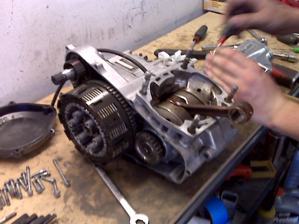

EY3BA11 Posted August 23, 2008 Author Share Posted August 23, 2008 Here is an updated picture that dannygraves took (motor is in 100 pieces at his place right now lol) Quote Link to comment Share on other sites More sharing options...
britincali Posted August 23, 2008 Share Posted August 23, 2008 (edited) Thtas a trip, Ive not seen gears look like that before. Even with all the chunks floating around my tranny the teeth still looked nice where they meshed. Did you get sand in there somehow????? Edited August 23, 2008 by britincali Quote Link to comment Share on other sites More sharing options...

EY3BA11 Posted August 24, 2008 Author Share Posted August 24, 2008 There wasn't any sand in the trans region however there a tiny bit sitting on top of the crank when we took it apart. Hi mike!! Quote Link to comment Share on other sites More sharing options...
