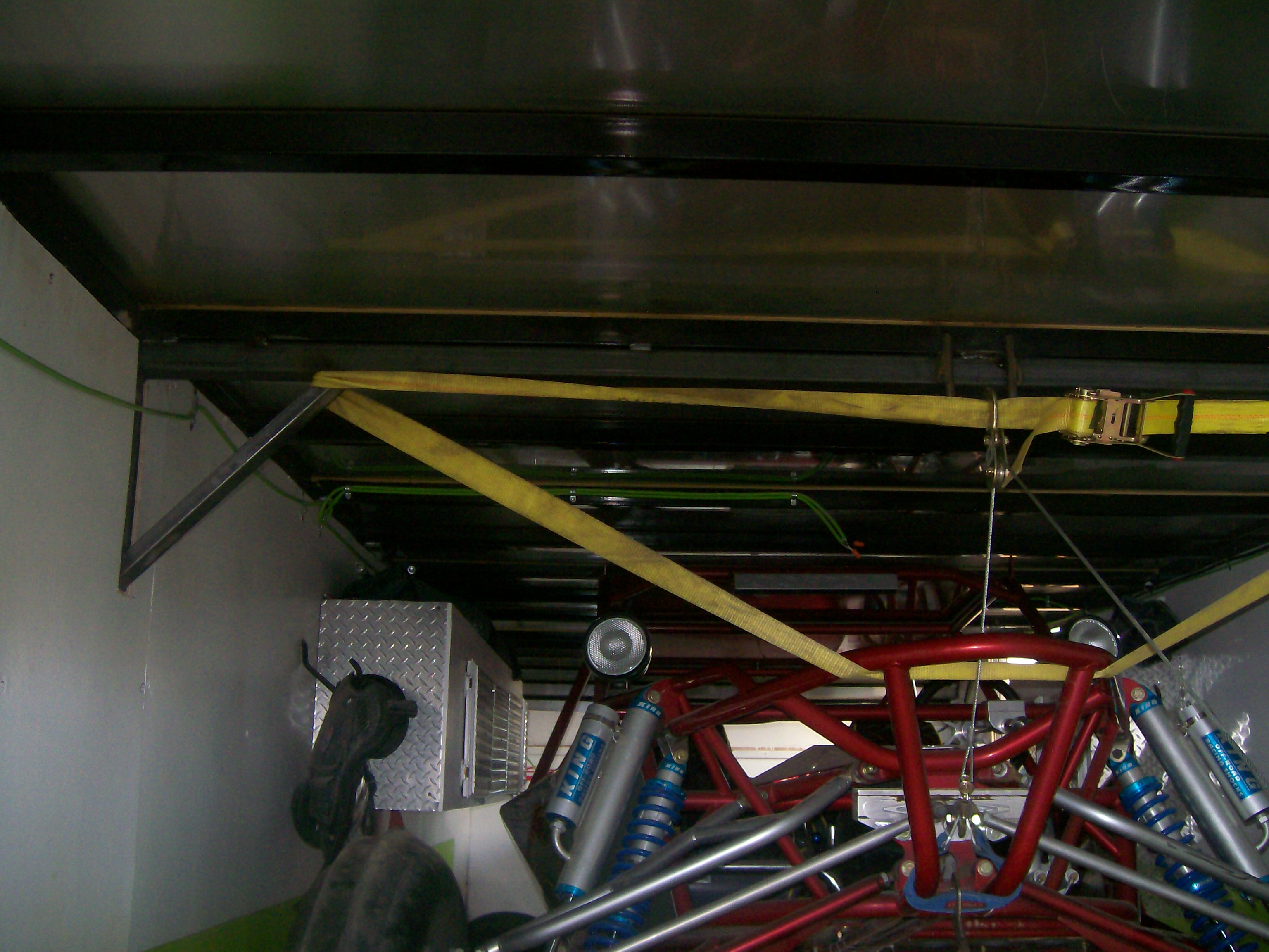

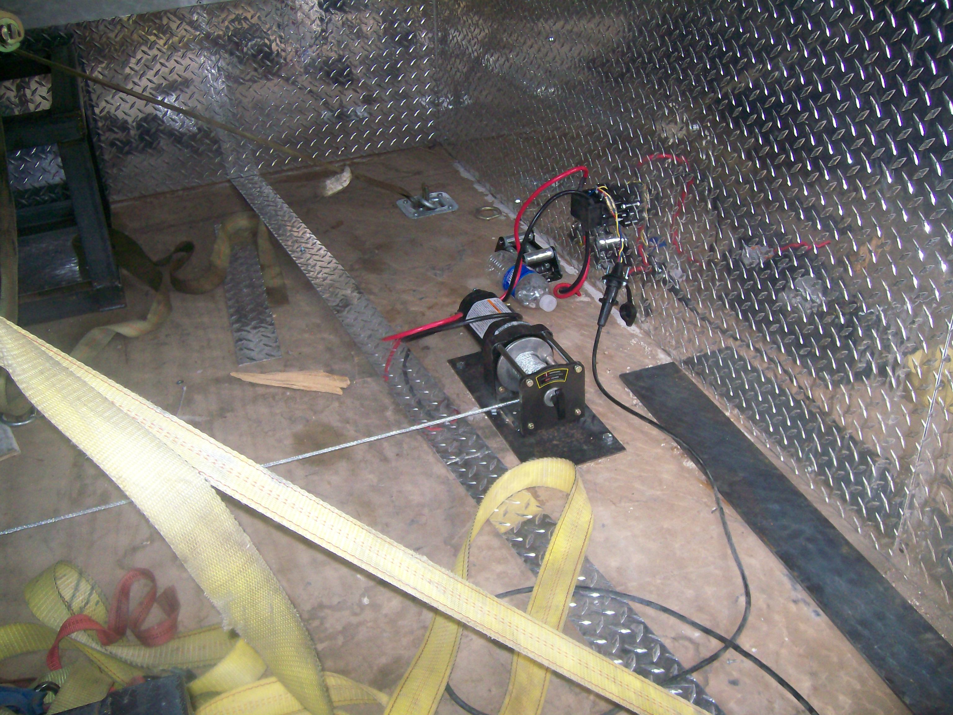

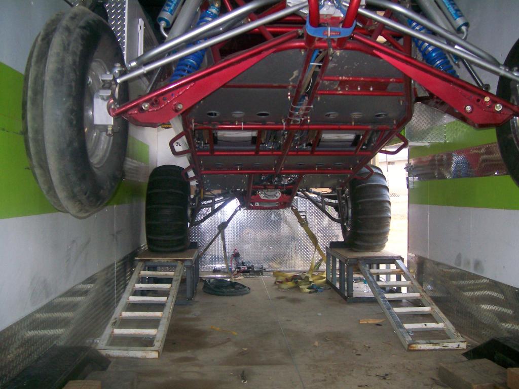

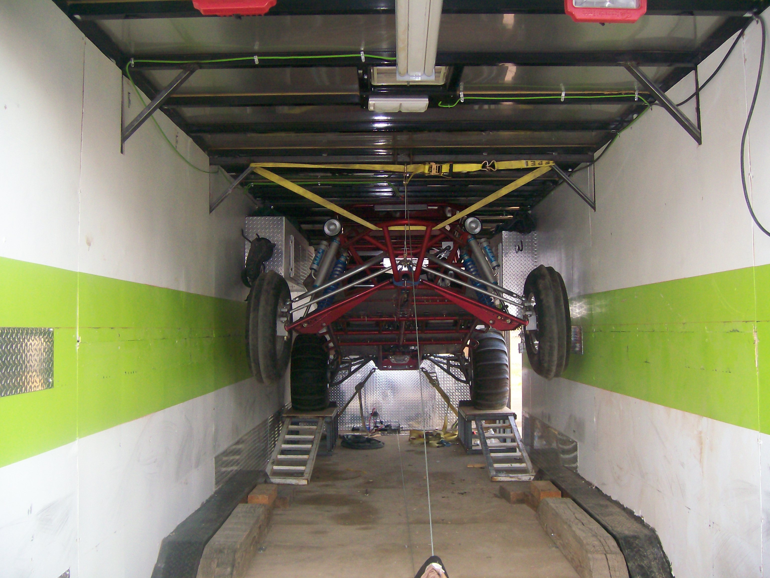

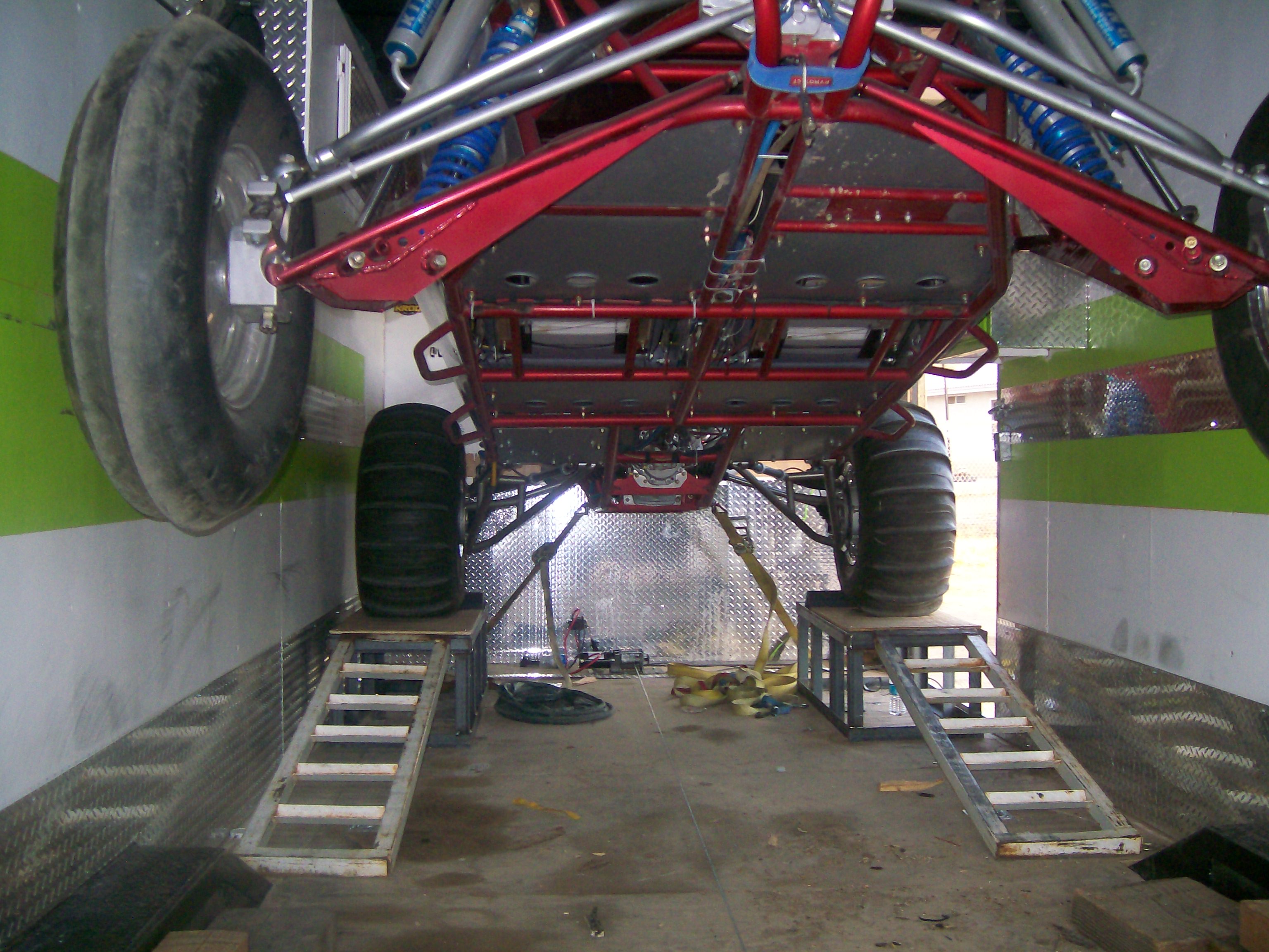

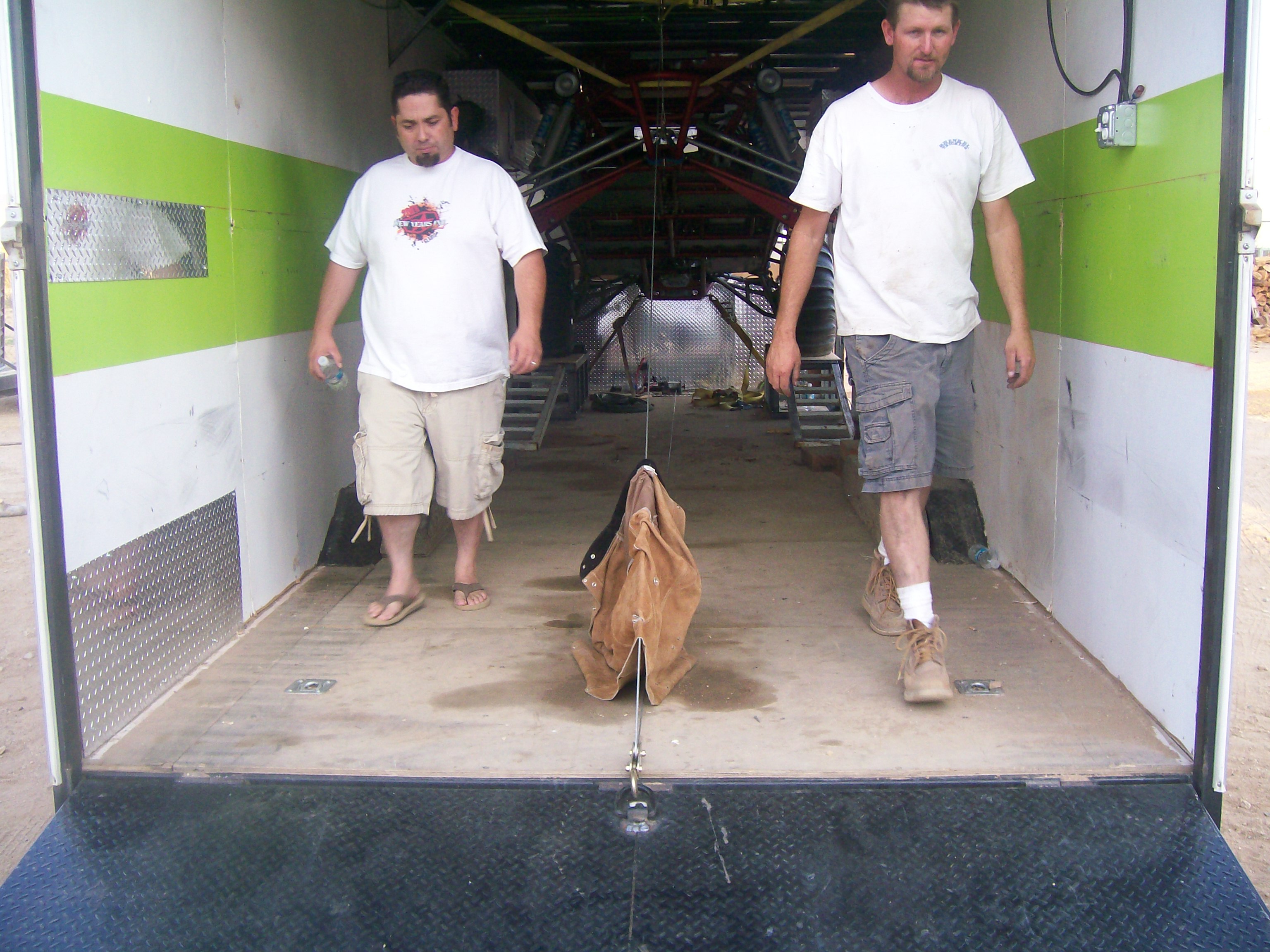

barefoot bob Posted August 25, 2008 Share Posted August 25, 2008 (edited) i have some photos of the stacker conversion were doing. semi stacker if you prefer but when were done we will be able to load 2 sand cars 16' and 16.5' and a quad in a 28' area. its not completed these are just some pics. and before you ask the yellow strap thats holding up the car is for saftey while were crawling under measuring. the car winches up. we will be using an a removeable a frame to prop the car up to keep the floor supporting all the weight. you will notice the gussets at the top of the wall. thats supporting the a frame for winching the car up. we were able to hide the a frame in the walls and put the wood back up. we already test fitted both cars and it doe work. a couple more weekends and it will be ready Edited August 25, 2008 by barefoot bob Quote Link to comment Share on other sites More sharing options...

dunefreak Posted August 27, 2008 Share Posted August 27, 2008 I hope she holds! Pretty genious idea Bob. Keep the prgress pics updated. I'm curious to see how the finished outcome is with both cars in there. So the front of James' car will just be hanging from the a-frame support over your car right? :ah: No ramps or anything? Quote Link to comment Share on other sites More sharing options...

barefoot bob Posted September 2, 2008 Author Share Posted September 2, 2008 (edited) lol ya we gutted the trailer crap is everywhere. anywase. when james car is loaded it will not be supported by anything on the roof or the walls. it will be held at the floor. the A frame is for simply lifting the car up. once lifted and a saftey strap hooked to the a frame we will bolt in a unit simaler to a saw horse mounted to the steel on the floor. under the frame rails of the buggy. the only thing the a frame will support is abot 3 inches of droop from the A arms on the car by simply strapping them up. all the weight and tie downs are from the floor. the ramps in the rear are 2 fold. 1 to keep the car from harming mine in case of a flat. and 2 we can put a quad under james buggy. this set up cost about 400 dollars and will save roughly 800 to a thousand dollars a season. elimination of a third vehicle , fuel entrance fees ect......... Edited September 2, 2008 by barefoot bob Quote Link to comment Share on other sites More sharing options...
