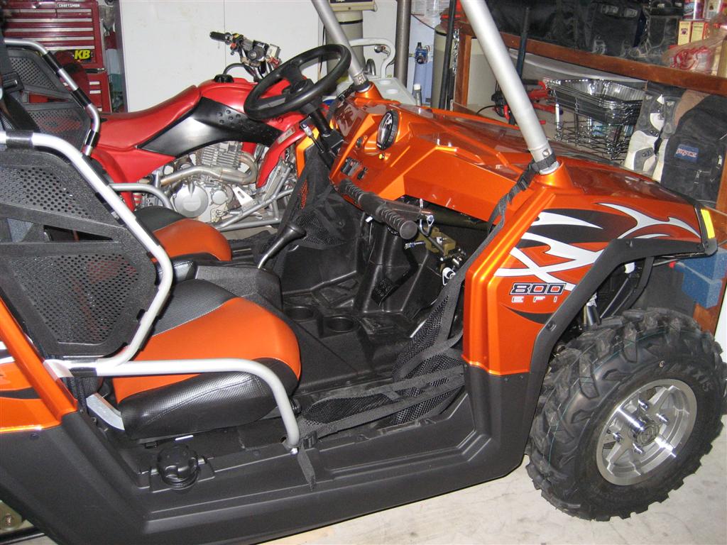

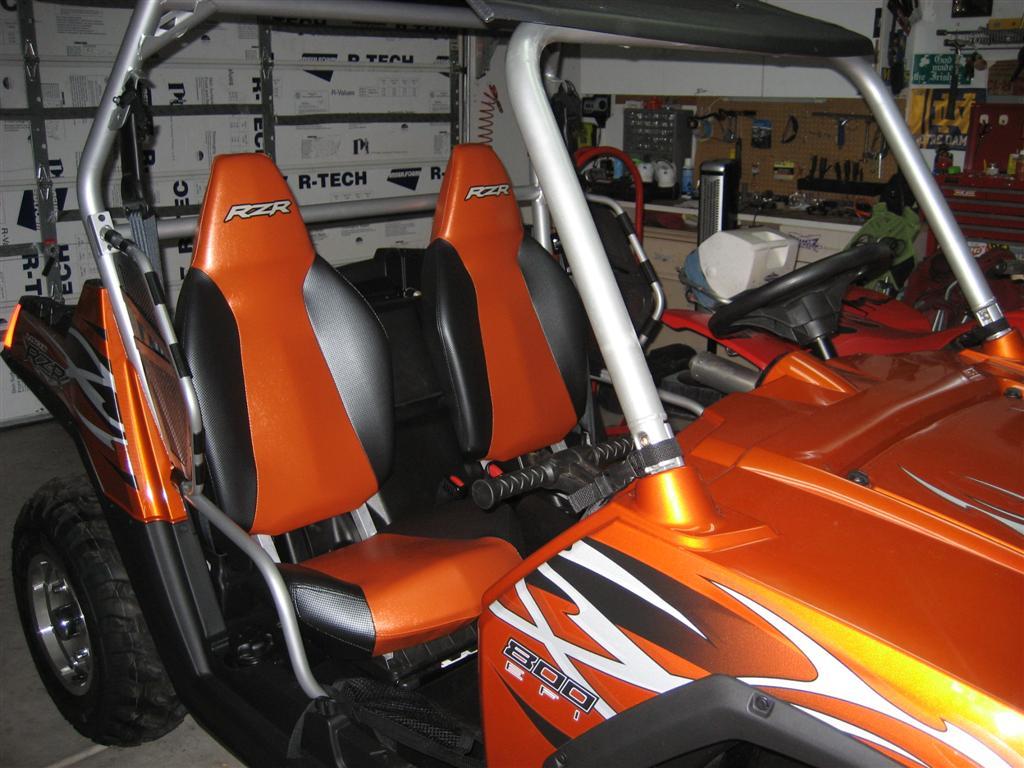

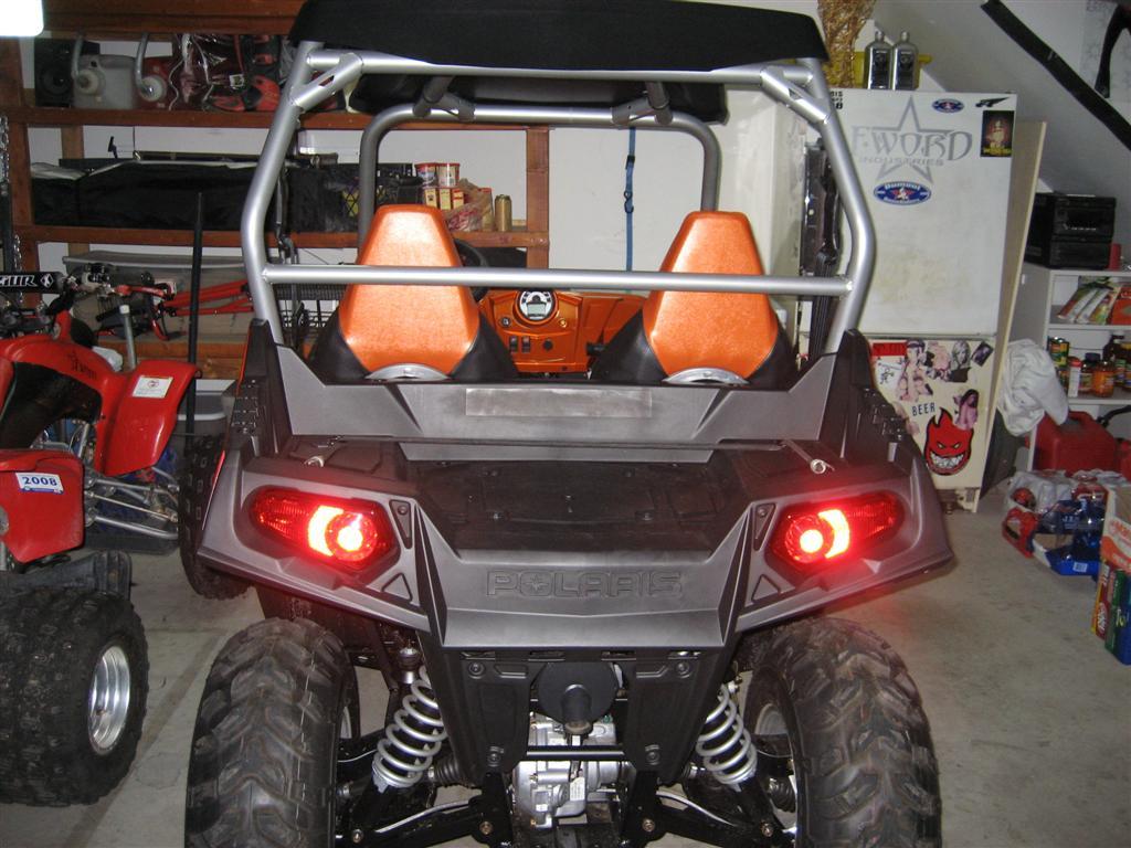

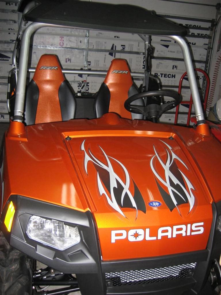

Well, me and the wife went last week and bought this bad boy. I friggin love it. 09 RZR Special Edition
