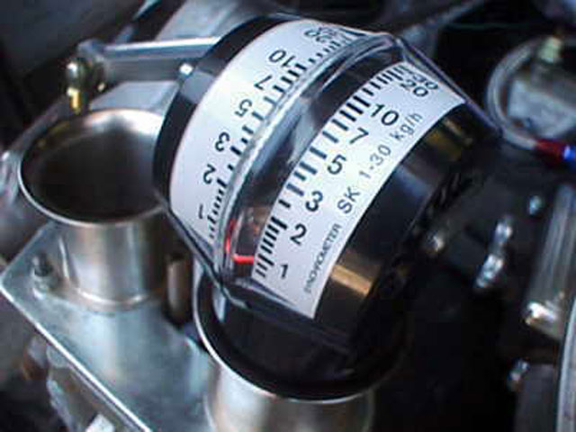

Be sure to get a synchronize tool for them dual carbs.
If you can find a Weber book get it too.
I had Dellortos and my book really helped me understand them.
Here's a pic of the tool. you can get one on Ebay.

Thanks Randog. Yup, first thing I get is the guage to sync the carbs. My first car was a 1641 Turbo that after a year I bumped to a 1776, the second was a 2-3 Turbo Ford. I will have to learn to work on the VW again. Carbs........shouldn't be too much for an old gear head like me. Directions with lots of pictures are the "ticket" for me. First thing I will do is kit the carbs since it hs been sitting for while. I'll get some pics up as soon as I clean it up and polish it too. I am a clean is quick type. Have a good day and Thanks

I have had good luck with my 1835 with dual weber 40's for the last 3-4 seasons. I bought a couple of books and the synch...but the last time I paid a guy to tune it up at beetle barn...he said it was tit's as far as being synch'd. No need to mess with it until it really goes out of synch. It's been nice, strong and reliable, although I can't wait until I can upgrade to some more horsepower. It's been a great starter motor.
